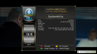

ysa63
The new image ...... HDMU Team back to Karnel 209
Only for the Processor STI 7110
HDMU_12115_E2_hs7110_209_git_5708_nodebug_mix_USB.zip.md5 Available to download
